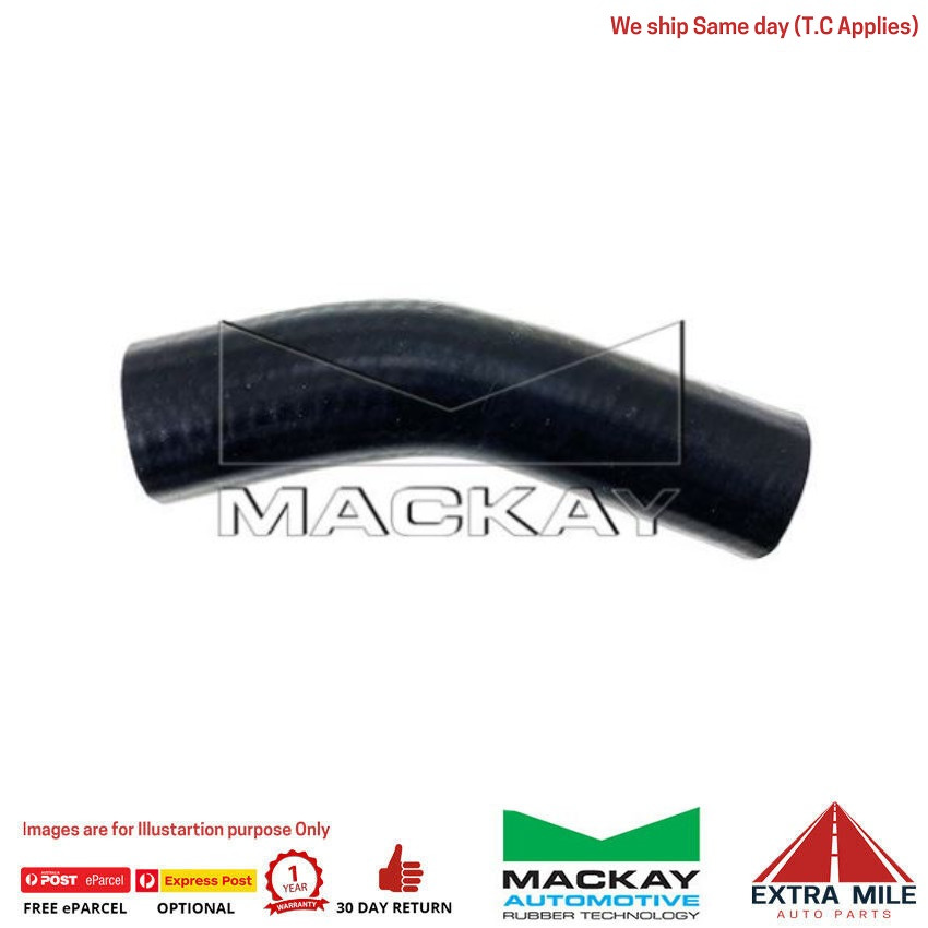

If you have no love chasing up the hose, Pirtek might have some hose that would suit - one of the lads at work had this drama and our local Pirtek had something suitable off the shelf and it cost **** all.
There is a mob on Fleabay that sells a "kit" to replace the factory hose. A short length of fuel hose and 3 or 4 clamps.
But the problem is, and I think I have this the right way round, the tank inlet is 32mm, the filler pipe is 28mm and the hose is 30mm. Or might be 32mm hose and 30mm tank inlet.
The hose over the tank works on, but you need 2 or 3 house clamps in the filler pipe ro make a seal. It's an any port in a storm type fix.
